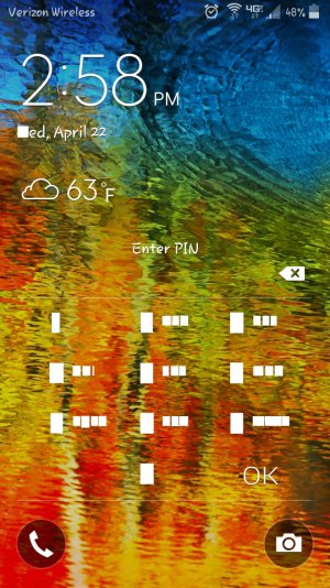

My locked screen key pad numbers are blocked in white squares, how do I get them back to black?
A
AC Question
does any1 know how to get it bk to bormal numbers ? its like its set to private :/

Yeah, mine has been doing this for about a week now on my Galaxy S5 and started right after the latest update. Very annoying...

I'm having the same problem and it has just been since Lollipop. For me it happens almost slowly, like 1 or 2 numbers will be blocks, then the next time it locks a few letters, then the next time a little more, until everything is a block. Rebooting helps them go back to regular for maybe 18 hours or so.

My Note 3 has been doing the same annoying thing after the upgrade to Lollipop. I usually just to a battery pull to get it to go away. Sometimes it's a day or two, sometimes it's a week before it reappears. No clue what's causing it, but a factory reset or cache wipe does not fix it.

I also have been having this happen since upgrading to Lollipop on my Galaxy S4, within the last couple weeks. Restart has helped as a temporary solution, but like others, the problem has recurred after a few days. I will try the cache partition wipe and hopefully that helps.

Both mine and my girlfriend's S5's have been doing this since the lollipop update. It's really annoying because I have to unlock my phone if I want to see what time it is. Has Android come out with a fix that actually works for this yet?

I have two users who are also experiencing this exact same issue. One says it occurs every 18-48 hours gradually turning to blocks and phone restart to reset the 'death-timer'. Did a hardware reset and it didn't fix the issue.
Searched for Open Bugs in Android Open Source's (AOS) bug tracker and none of the 300 that matched "lock screen" were this issue. Unfortunately, this issue has been shown to occur in only Samsung products so far (S4, S5, Note 3) and so since those are heavily-customized Samsung-specific Android code, the vanilla Open Source bug tracker won't provide support.
It appears the Samsung Developer Forum's is the only/best place to report the bug: developer.samsung.com/forum/en
