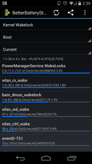

Re: Battery Very Inconsistent - What's the culprit?
I installed a BetterBatteryStats to see what is causing the drain.
Unfortunately, I've already rebooted my phone which means I should be getting "good day" battery now. So, I'll have to wait until it has a "bad" day again to really know.

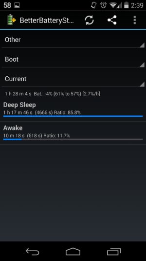

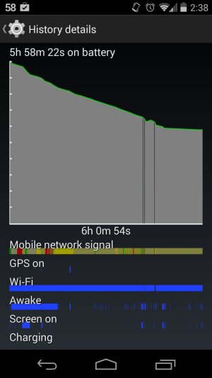

onthecouchagain
Aug 12, 2010
967
17
Visit site
It's happened again. Notice before the reboot, how steep that drain is. Then after reboot, it levels out back to normal days. Still no clue what the culprit is. Wakelock patterns the same. Radio signal the same (I mean, same office at work all day). And no real different usage pattern today than any other day (note the time when the device and screen are off -- what is causing that steady battery drain?). This is all just like before and just like what I detailed in my OP. Don't know what causes this random quick drain that gets fixed after a reboot.
Android needs to get this bug sorted out because this inconsistency is very annoying.
