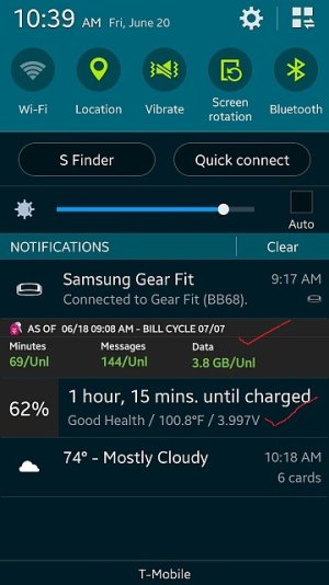

been on the charger for about 30 mins. Taking it off here and there to answers messages, incase people wanted to see the temp in action
Hi
Can you please tell me
which are the Apps you have
1) showing battery meter
2) your phone data & mins
Thanks

Hi
Thanks
The battery meter I'm unsure of as it could be many. I use GSAM personally but that's not what theyre using.
The data appears to be a T-Mobile My Account application.
