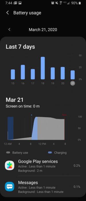

Below are two screen shots that capture two battery level crashes this week from ~30% to 0, with the apps listed at the bottom. Doesn't look like unusual usage, but maybe this isn't what you were looking for?

Yeah those stat , I dont see anything out the ordinary , but do 5 % to 100% and monitor again.

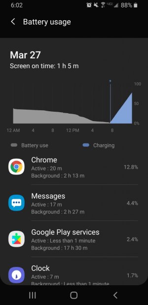

Interesting update- I ran it down again in Safe Mode and got the same result, battery crashes below 30%. Then I read elsewhere on this site that someone with a similar problem did a slow charge from the usb port on the computer so I gave it a shot. That seems to have had an effect, at least for the moment. See the result of running it down after the slow charge below.
