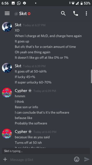

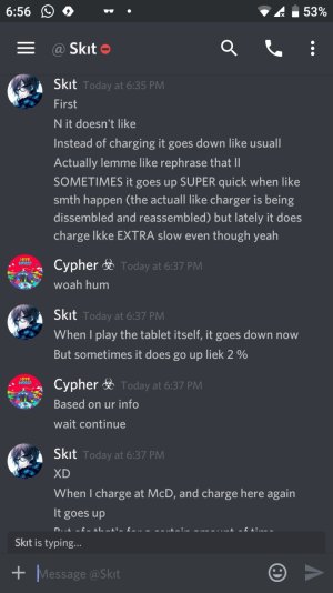

So my friend's tablet (mentioned in title) is having veey wierd battery issues.
NOTE : Ignore my sent messages, focus on "Skit"

I'd diagnose a bad battery (the amazing thing is that a battery that's been that badly treated [bringing it down to 0% or 1%] has lasted 7 years).
Tell him to have the battery replaced, and start getting in the havit of charging it when it drops to 40% - he won't be as lucky with the next battery.

Time for a new battery, but I'd also consider replacing the tablet itself. I'm sure it's suffering from other performance issues as well due to its age, and it is no longer getting security updates.

She did get the battery checked, "and replaced twice it but it still shows the issue. I know it's pretty old, but she can't get a new device :(

Sad though she can't get a new device. The tablet was also "checked" and the battery was replaced twice by a repairguy, but the issue is still present.
