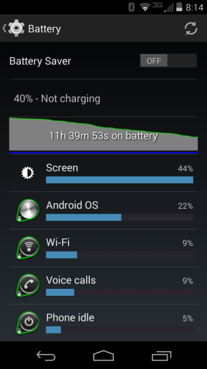

after spending a day at home locked onto a strong wifi signal this was my result

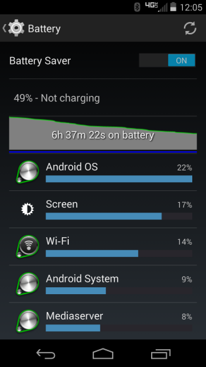

Now, today is a work day. Pulled off charger at 5:30am and drove to work. When I arrived at 6:45am I was down to 82% battery. Battery stats show Media server wsas the big hog. Reset phone and it seems to have settled down. here is my usage by lunch time:
Difficult to tell how it'll last until 5:30-6:00pm when I leave.
I'll give it some more time to settle out.
