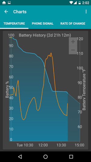

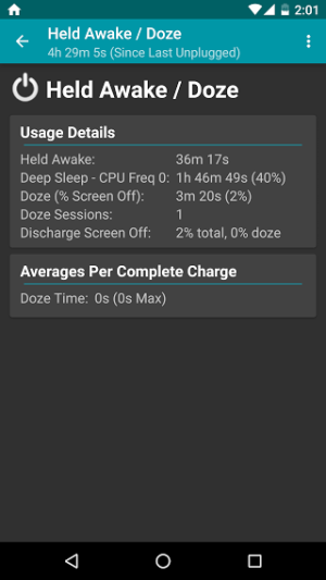

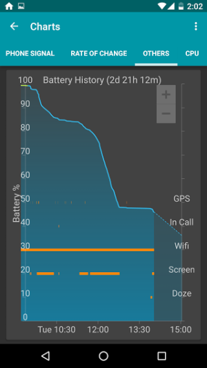

GSam Battery Monitor has been updated on Feb 14th to Ver. 3.28 and now includes some Doze reporting! I did a test by turning the screen off and putting my Pure face down for about an hour (interrupted by a text notification). Hoping to be able to put 3 pics on this post ...
First Pic is the Power/Temperature graph & shows a nice flat line, second pic is the 'Others' tab showing one little mark on the Doze line and the third pic is Details of the Keep Awake/Doze item from the base GSam screen listing one Doze Session for 3 min 20 sec. I'm thinking it was triggered at the end of a Deep Sleep interval.
The Deep Sleep reporting (also new?) for 1 hour 46 min is likely a total of all the parts of the Awake line on the regular Moto battery chart *not* showing, so I'm inferring that the Pure is doing a good job of Deep Sleeping even without Doze being in use.

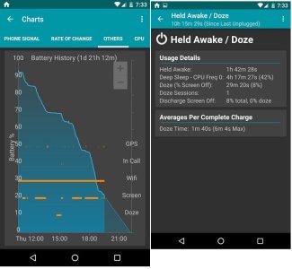

This time I wasn't doing a 'test' - just 'dozing' in the recliner with the Pure in the top pocket of my Dickies bibs! Much longer Doze time for the single Session reported.
(and a great nap!)
