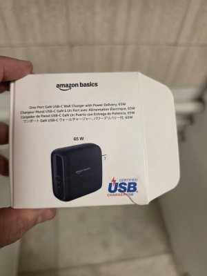

I got the Amazon Basics 60 watt charger and tried with the cable that came in the box and the 5 amp cable I used to charge my S25U and am not getting fast charging 3.0
Anyone else have this issue?
Which 60w charger you bought?
It does not, what is strange is that I'm getting fast charging 2.0 with my 45 watt anker and with the 65 watt it's slower
How does this makes sense lol
I ended up getting this charger
If we look at @tcdude's picture, the first line says Power Delivery 65 watts!
It has to say this
It has to say this

Yeah that's PD 3.0
