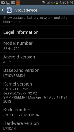

any help would be appreciated I have included pics of what is running on her phone now after all this

The update won't complete on a phone with a custom recovery, so it's not likely she has the MK3 ROM or bootloader. You can go into Settings / About device and check the build number, Baseband and Kernel to see.

this is her set up
That's weird. I can't see the image in your post, but can see it in my reply.
Anyway, your Android is 4.1.2, not 4.3, and baseband (modem) and build are MD4, which is the last version prior to MK3. And April 15 is the MD4 kernel. So it looks like you're good to go.
But before unrooting, you might want to read the posts about 4.3 and Knox, and decide if upgrading is worth it.
