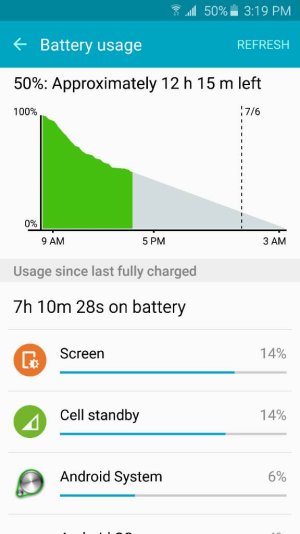

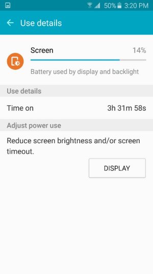

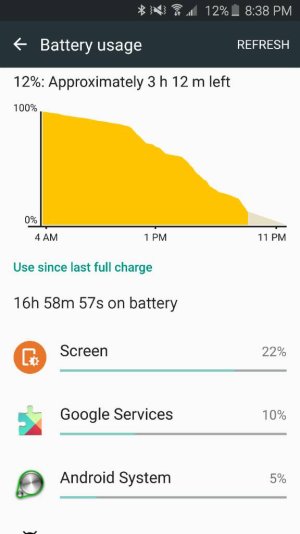

6-) Report diagnostic Info - It has been reported by some users that turning this off helps preventing wakelocks, turning it off doesn't seem to affect anything. Go to Settings- Privacy and safety.
I just read this tip the other day, and I think it is responsible for a huge increase in my battery life. I tried turning this off the other day, and I haven't done anything else differently (and I'm still on 5.0.2, thanks Rogers).
I have posted many times on these forums that I was getting a full day (16 hours) plus 4 hours of SOT.
After this change, I'm on track to get a full day and break 6 hours of SOT! (similar yesterday as well)
At 50%, I'm WELL over half a day (I'm over 3/4 of a 16 hour day) and I've already had 3 hours of SOT.
(if you're wondering, I woke up in the middle of the night around 3:30am. I decided to unplug my phone then so the green light wouldn't light up ceiling any longer. I usually have a 7am-11pm day)

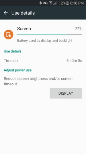

I didn't quite make it to 6 hours (as I hoped in previous post), but this is certainly the best battery life I've had yet. I went out for a bit and was in a different building, possibly weaker signal, but may have nothing to do with it.
Either way, I had 17 hours on a charge, 5 hours of SOT, and I still had 12%. I didn't want to push my battery any further, so I'm not sure how far I could go beyond that. Probably another 30 minutes SOT, maybe more? Anyway, happy with the results, I'll pay attention for the next few days and try to get an average.

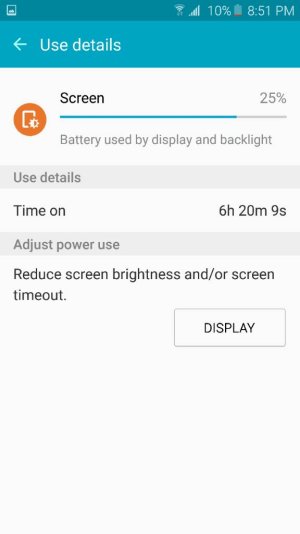

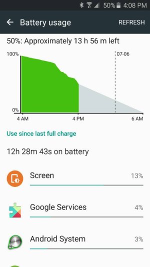

I suppose if I were to double this I could get 7 hours of SOT. But when I'm working on weekdays I struggle to get 90 minutes SOT at 50 percent.
Took the battery down to 10 percent and was able to get 6 hrs 20 min of SOT. This is under normal power and auto screen brightness and the screen was on indoor lighting brightness.
Now if I could just get the cell standby under control.

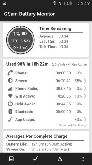

Erasat I am now 99.9% sure my inconsistency with battery is due to the problems with the phone radio.
This was my battery life today on WiFi and airplane mode switched on
There you go, I'm glad you decided to follow my advice and try this, like I told you then, this will be your definitive proof that your problem is just Cell Signal (or Radio) and not just other glitch on Android OS or other Samsung stuff. I don't know you, but that would give me peace of mind and at least will save me of more time trying to troubleshoot the issue. I'd definitely keep calling and stalking Telstra until they get a fix with Samsung on this.
