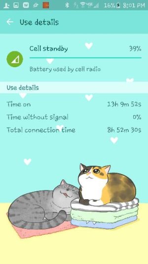

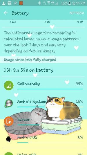

Can someone pls interpret this for me and explain it in kindergarten terms?, ty

Wow.....I have never seen a Cell Standby at that percentage. Holy smokes, your poor battery. That sucks.
It could mean your phone is working very hard to maintain a signal. I think the usual cause of this is a very weak cell signal. For example, if your phone is kept in a basement overnight with weak signal, there will be very high cell standby (and battery drain) in the morning.
Is there anything I should adjust to make this better?
If I look at your screenshot, it looks like you have a pretty weak cell signal. If the signal is usually that weak (e.g., at home) then the first thing is to always keep wifi turned on. If wifi is turned off, the phone the phone has to use the weak cell signal, which uses more battery than wifi. Also, you might want to call your provider to complain about weak signal. They may be able to do something about it. I know AT&T used to have a deal where they would give you a free network extender for your house if you had a weak signal there.

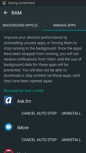

The Indian version of 5.1.1 became useless to me when in a smaller update they got rid of the auto stop feature. Like seriously wtf
Thanks to the xda forums I just found out that the auto stop feature still exists on the Indian firmware. It is now however in the ram management section instead of the battery section. No longer feeling the need to download Australian firmware :)
Aww man thanks for posting this, I was gutted to lose that feature. Glad it's still there ☺
You're so welcome. I thought I had lost it too which was why I was desperate for the Australian version of 5.1.1 to come out but apparently it had just been moved without anyone letting us know lol
Remember that you can also use Doze and it does a pretty good job for Standby time. The combination of this 2, Auto Stop to completely close the app after a certain amount of time and Doze to prevent that even he ones you don't want to Auto close don't keep using Data in the background works very good for any Android phone right now.
