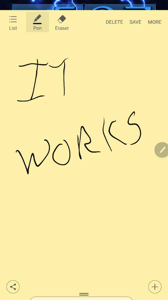

'it work perfect with me contact me if any problem and inform me if it work on my facebook thanks all😉😉😉
I hope it's working now... in case it hasn't, i had the same problem... "greyed out Air Command" i tried switching mode from Standard to Easy Mode... pulled my S Pen... air command worked, :D ... switched it back to Standard... Viola... although I'll try restarting my phone just to be sure it stays that way...

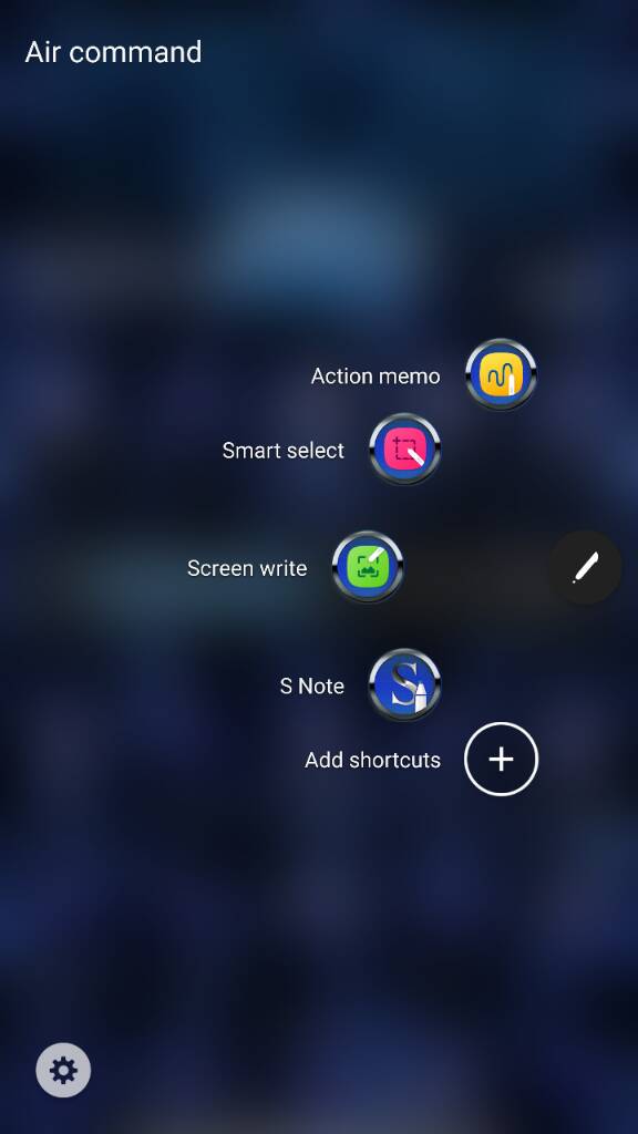

This worked for me! Accessability- switch access on, then Off. Hover to Zoom on, then off. Immediately got Air command back. Note 4.
for my Galaxy Note 4, it works like magic. I lost my air command menu after upgrading marshmallow. I followed below steps:
1. Take out s pen
2. Go to accessibility
3. follow vision
4. Switch Access - On then Off
4. Hover zoom - On then Off
5. Click s pen button keeping it over the screen - - I got my air command menu back.
