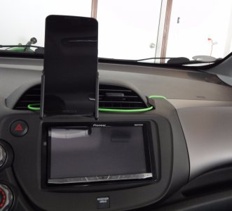

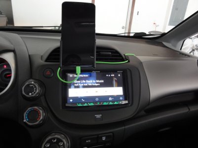

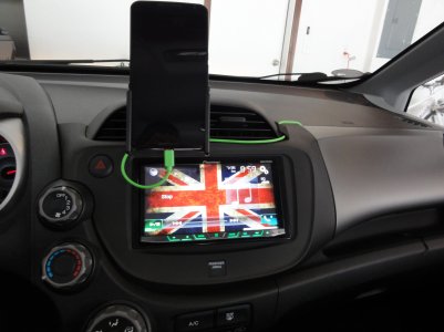

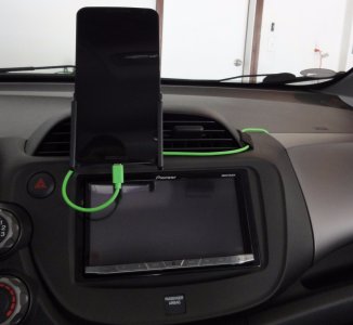

After a week with the AVH-4001NEX I'm pretty happy. I have a 40ish minute commute and it's been far more tolerable this week with the convenience of Google Traffic data and easy access to entertainment. I had the install done at Best Buy and even though I had some reservations when they dropped it off, they did a great job (even though they were over an hour late, I'd rather they didnt' rush it so I'm not really complaining). The dash kit is meh, not really a great color match but it's close enough I'm not annoyed. I also left my ProClip up (which means I had to route the data cable to more visible space) mostly because if I'm just running to the corner for something I probably won't hook my phone up, but my phone it big enough I'd rather toss it into the holder than have it in my pocket. Attaching a few pics, they aren't great because they are from old my old point-n-shoot, but you get the idea.
