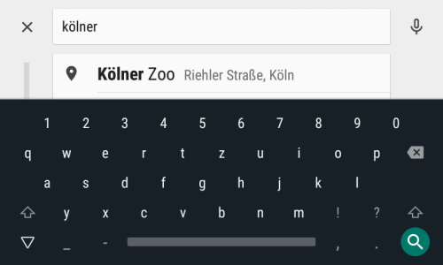

How is it that the number of touches with things like playlists, etc. is limited, yet you can access the search field where it brings up a keyboard? That seems completely contradictory to me...

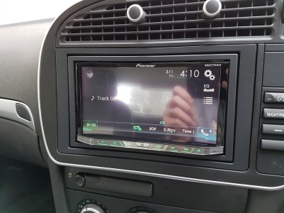

Hello,
I have a Pioneer AVH-8700BT, and Android Auto has been pretty good so far. I like the ability to say "Listen to XXX" and it'll find it on Spotify for me :)
One thing I'm struggling with, and I have searched the net a lot, is turning the navigation volume down. I've turned down alerts, and android auto, but the navigation prompts are still full volume.
Is there any way to control this independently?
Thank you

There are three voice level settings in Maps on your phone. They affect the voice guidance levels in AA. Of course if you're already on the low one, not much more you can do.
