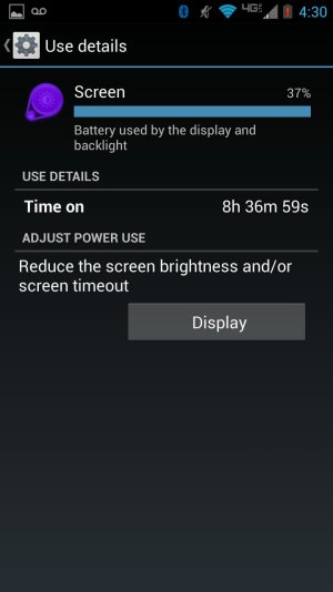

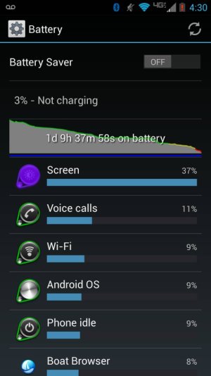

Off charger Friday at 630am and just now put on charger. Was hoping for 9 hours screen time, lol
