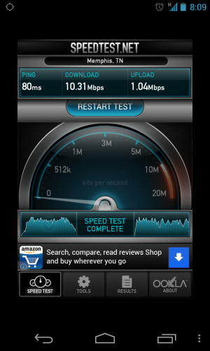

This is the fastest speed I have gotten... At ATL airport. On average in Orlando, I am between 2-4

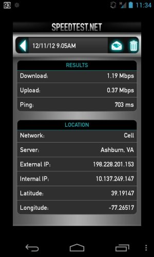

Does anyone know why Speed test app says my data is over cellular and not HSPA. I even have the pta apn running and 4g LTE smartphone plan.
It is denoting the type of connection, cellular or WiFi.
It does not mean the type of cellular (i.e. GPRS, EDGE, etc.) connection.
Dan
