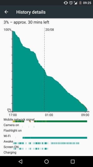

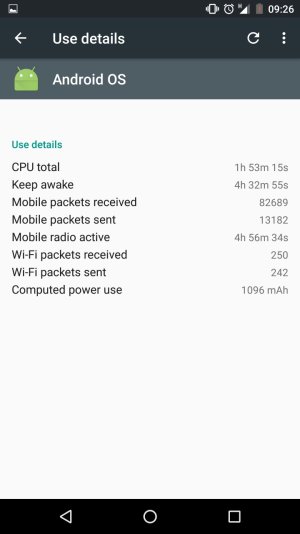

This is absolute insanity. Left my phone at 44% for 8 hours and it dropped 42% due to Android OS. WTF. I'm going to Nougat DP5 to see if that improves things.

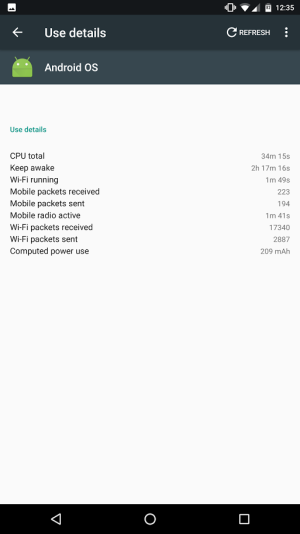

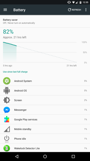

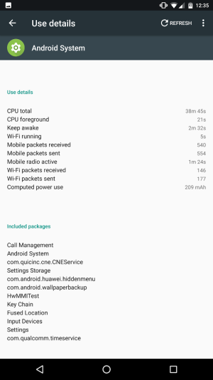

Have upgraded to the official 7.0 Nougat release and problem is still occurring on my Nexus 6P. Using Wakelock detector, seems as that "wlan_rx_wake" is keeping the phone awake, as well as "PowerManagerService.WakeLocks". Android OS and Android System are draining my battery when in standby, keeping the phone awake.Screenshot_20160830-123528.pngScreenshot_20160830-123536.pngScreenshot_20160830-123540.png
FYI, issue only happens when I am at work, connected on the work WiFi.
