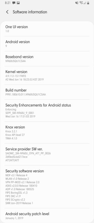

I want to thank mustang and Ruben for the help. I got up to January! But the current SPL is March and soon to be April. Does anyone know how to get current?? Here is a screen shot of my device.
Hi Megan, I made a stickie here in the note 9 forums for March
