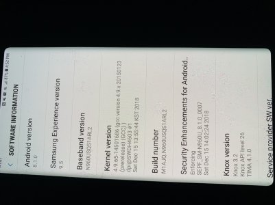

I have at&t on note 9 and don’t have update either. This is my software information. I’m not smart on technology and have no idea what to do
It has to be something with att system. I've been having issues with updates since I got the phone in September. I've had to sideload all my updates. Even had to do that with pie.

Super frustrated. I had no problem getting the update in December so I don’t know what went wrong with my phone.

I need the last update. My phone is stuck on December as last update. I tried the last link using the computer method but either I don’t know what I’m doing or something but on the last step, it told me file not found.
