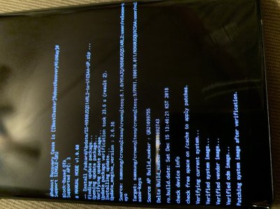

I’m trying it again. It’s doing this right now. It didn’t do this earlier. How long does it normally take from this process? It’s been like this for a few minutes.
Okay it finally moved on from that and rebooting now. Will that be it? I don’t have to do anything else except check update to see if I can get pie now?

You'll need a sd card to copy to then restart your phone in recovery and let it load up .
Recovery is easy all you have to do restart device before screen turns on hold Bixby,volume up , power button same time then you'll andriod bot release you'll be in recovery mode with a menu you scroll down with volume up and down buttons to you see sd card update choose with the power button you'll see the file you copied hit power button one more time and wait for it to load 15 to 20 minutes.
Very Easy what do you think ?
