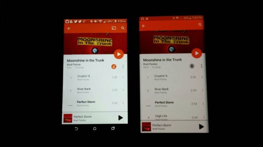

Same problem here. M8 and S6 on right.
Try using your flashlight on the m8 and shining it directly into the light sensor on the s6, it should go full brightness. But it will revert once you lock the phone (screen off and then back on) .
Leads me to believe it's a software glitch and can be fixed with an update.
