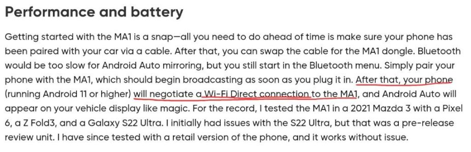

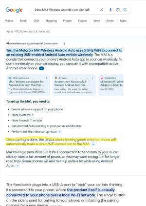

No, you initially PAIRED over bluetooth. From there, it sets up a WIFI connection. AA Always requires Bluetooth in addition to Wifi or Cable. The transfer demands are too taxing for Bluetooth alone.
If you use Wireless, it consumes your Wifi Antenna as that only allows one connection.
I haven't set up from beginning since I had it but trust me I turn Bluetooth on then go my radio AA app and connects through that my WiFi not on . I'll try to make a video for you .
It may appear that way. But, it sets up a server and turns your wifi on for a direct connection. This happens in the background. That is how wireless android auto works, even through a dongle. Video is too much of a Bandwidth hog to work over bluetooth. It sets up a "server" on the receiver side and your phone connects over Wifi. Bluetooth is required for the setup and as the trigger for subsequent connections.

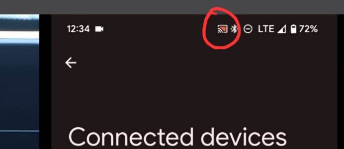

This method I did with my vehicle
  • Like
Reactions: Laura Knotek
Yes, and if you look at his phone, you see the little red Direct Share Icon. That shows it is using WIFI for direct share. If you notice, the bottom left corner of the direct share icon is a wifi symbolScreenshot_20240422_133237_YouTube.jpg
