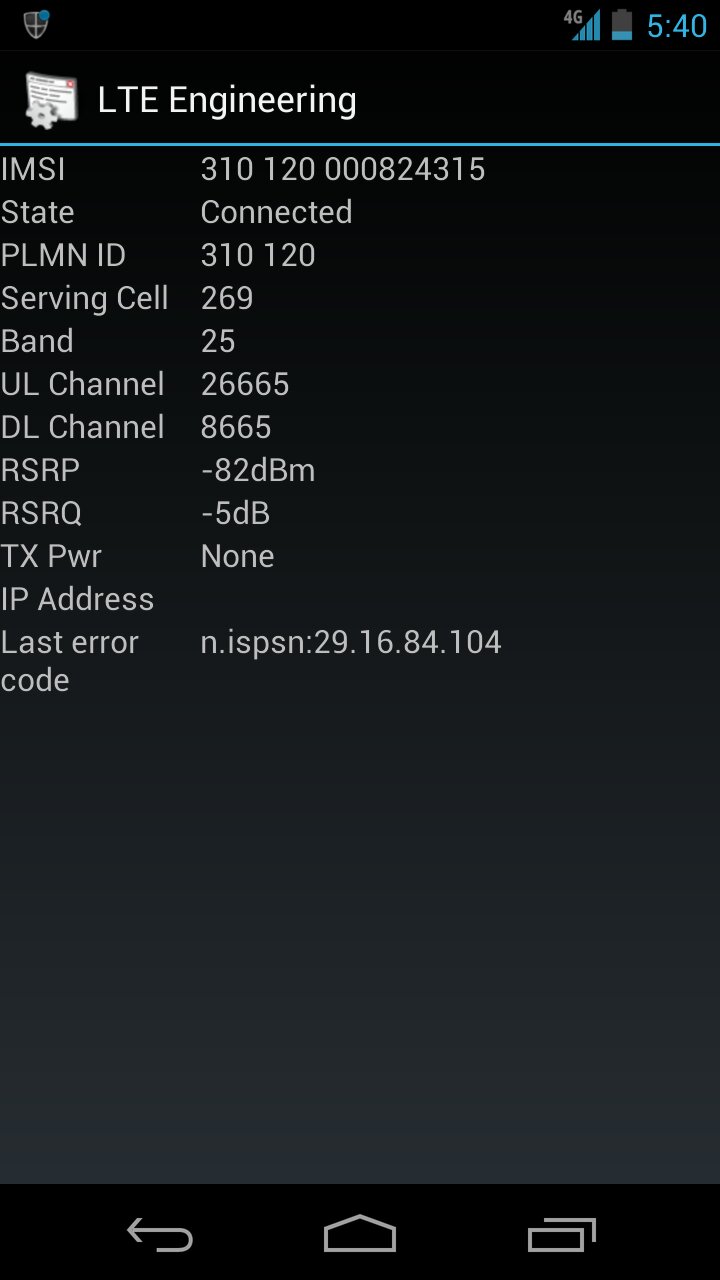

Finally remembered to check this while I had a 4G signal.
Mav. :cool:
