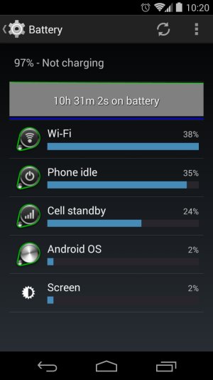

what carrier are you on? it looks like you only have 1 bar of signal. if your phone has to work and struggle all night to find a lock a cellular signal - it will burn battery.
Tmobile. You make a good point, only before the update it would drain to 95% overnight and not 75%.

Looks like I found the culprit. Poor LTE signal from Tmobile. So I lowered to 3G and now only 3% drain overnight.
