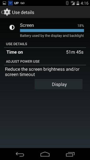

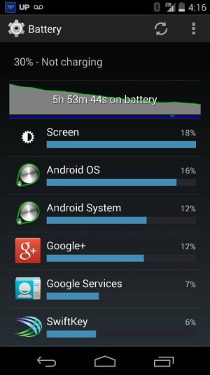

Yeah, something is up with my battery since the update. This is significantly less than what I've been used to.

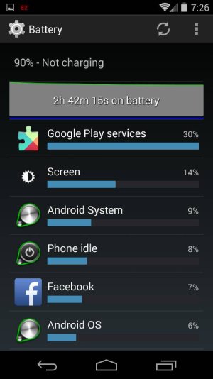

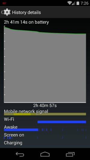

Interesting how wake drops off when wifi is on. I know it's a short term sample....
Posted from my Nexus 5 via Android Central App
