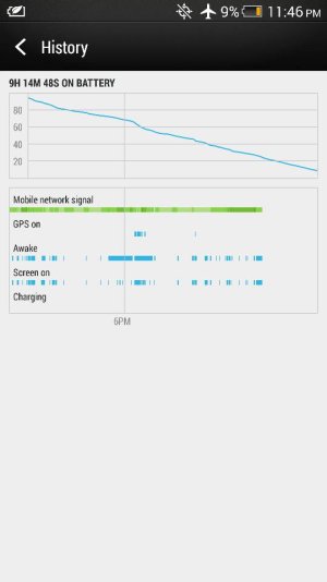

My HTC one battery is draining very rapidly after the 4.3 update. Attached is screen shot, notice how it kept draining even on airplane mode. Any suggestions?
Thanks.

I believe I figured this out. After the 4.3 update all the Google location services got turned on. And that is what is causing the battery drain. After turning them off, battery is discharging at a normal pace.

I turned off Sync to all of my accounts since my battery was sitting on 44% for 2 hours while on a charger. I also turned off Google location; unchecked all 4 location settings. Something else that I noticed was I had both WiFi and Mobile Data on and when I switched to just WiFi I noticed a difference.
After doing these three things and in just 30 minutes, my battery percentage went up 7 points.
I use the power saver and keep my screen dimmed, any way so I wasn't concerned that that was a problem. We'll see what happens tonight but so far it's looking good!
