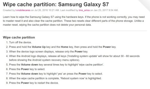

See attachment for instructions for wiping the cache partition. Just be careful as you're scrolling down the list of options to NOT select the Factory Reset option (I think it's just above the Wipe Cache option). And always good to make sure your phone is backed up prior to doing anything like this. Samsung Cloud, Google, Microsoft OneDrive ... whatever you choose. Can also connect phone by USB to backup to computer.
Good luck!!
Good luck!!
I am going to try that. Thank you!
