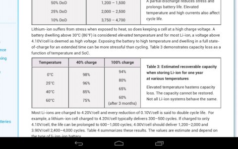

Leaving a battery at 4.2 volts for an extended period of time was shown to stress the battery and reduce it's capacity according to a Battery University study. Since LiPo chemistries vary as do manufacturing techniques this data may not apply exactly to a particular set of N7 batteries.

I believe that study refers to keeping 4.2V supplied to the +terminal of the LiPo. I am pretty sure that the charge manager deals with that and disconnects it when terminal voltage is reached. All batteries will self discharge and I presume the charge manager will kick in to top it off when that happens.

The point of the study was that maintaining that particular test set of LiPo batteries at above 4.0 volts reduced the battery health ( amount of watt-hours stored at full charge). If you assume that this result applies to LiPo. batteries in general you may conclude that it is somewhat harmful to leave your tablet or cell phone on charge at about 4.2 volts for an extended period of time. Thus when the charging is done it is a good practise to take it off the charger. But don't worry too much about this. Batteries can be replaced although that is not easy with some devices. See iFixit site. Replacement of the N7 battery is quite easy.
