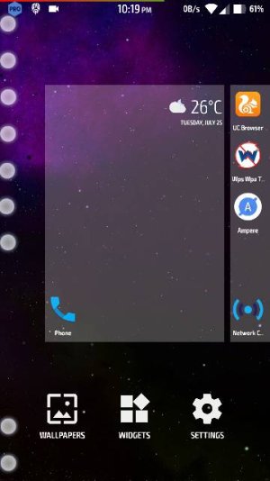

My phone has ghost touches problem. When I remove the back cover, I see that my battery is swollen. When ghost touches happens, I plug in the charging cable and the ghost touches will gone temporarily. And I wish to confirm that does the swollen battery makes the ghost touches problem. If yes, I will change the battery. Any answers will be appreciated. 147881.jpg

As I said, if the ghost touches happen, I plug in my phone and the problem gone temporarily. Maybe it is about the stability of battery current problem. A swollen battery power current isn't stable.
