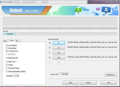

Also, the instructions tell you to download "Odin", but they don't say what version to go get. What he describes is the interface in Odin 3.09. In v3.10, there is no way (that I saw) to check options as required. There may have been a menu somewhere, but I didn't see it and I didn't spend a lot of time looking...so I downloaded 3.09 and found what he described in plain sight in that version.
When Odin is loading files, you cannot do anything. But after it's done, you can check any option.
