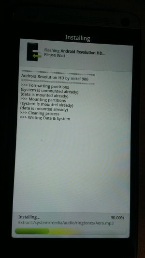

Long story short, I couldn't get into recovery mode. When I finally did and tried to flash it so I can revert back to Sense based ROM, the installation got stuck.
I tried installing Android Revolution HD but the installation is stuck at 30%. It's been an hour now...

Is there a way we can get out of this screen though? Cause nothing I do really works. Tried holding down the power button and volume key for up to 30 seconds
Is there a way to restart it from the computer? And if we DO, will there be an OS on it?
This is the screen I'm stuck at. Hopefully this helps :(

If there were some way to shut it down, I'm assuming there would not be an os on it.

So shutting it down won't help either cause we won't have anything to boot, right? What should we be trying to do
