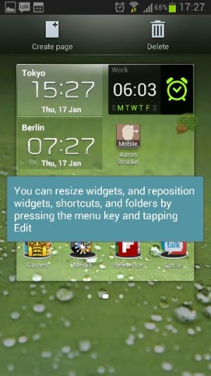

Here's a screen shot of what happens when I just hold down my finger and try to drag an icon. It contradicts itself by bringing up the bin in the top corner and appearing to let me move an icon, but nothing sticks. It brings up the message you see on screen, and reverts back to how it was as soon as I release my finger off the screen.

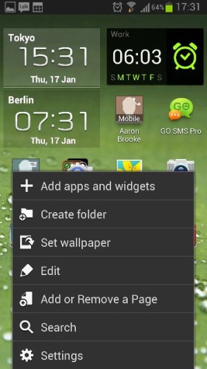

I can only move icons and widgets through Edit in the menu in the second screen shot attached.

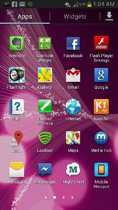

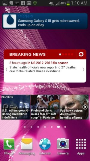

I have to add icons and widgets from here..have to choose apps or widgets at the top, long click on them and then it will move them to my home screen. I can't do like Gingerbread and long click on my home screen to add, it won't stick then.
Now I REMOVE from the second screen.
