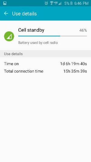

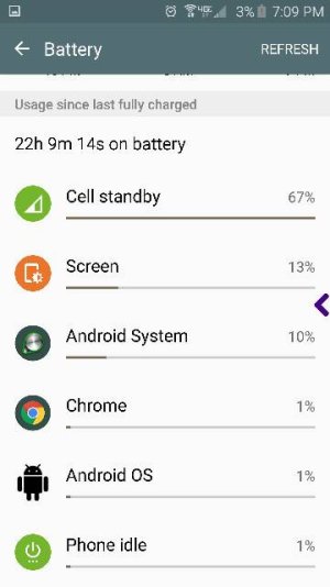

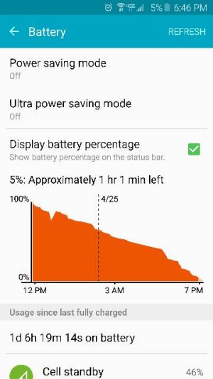

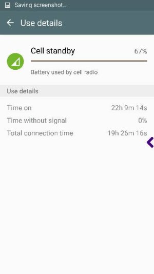

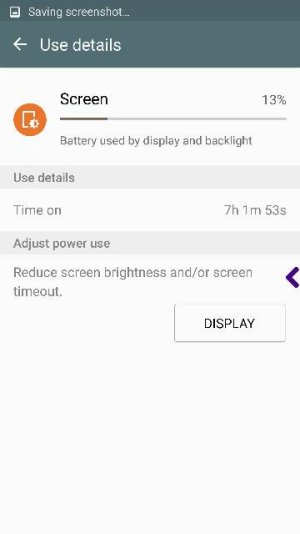

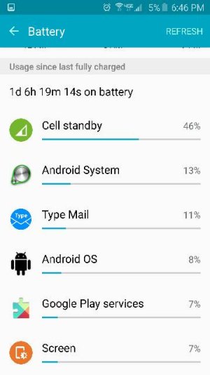

I'd just like to step in and ask is this cell standby issue really hurting as much battery as we think it is? And if so, how much better can this battery life get once it's remedied, because I gotta be honest my battery life has been pretty great since I got the edge. The regular s6 battery life was dreadful, but it's a different story all together with the edge for some reason, yet my cell standby percentage is quite high. This is what I got since last charge:

5 hour SOT is quite good. I'm getting around 4 myself with around the same cell standby as you. If/when there is a cell standby fix I'm hoping that SOT will increase.
I think it's hurting my battery quite a bit. If I use gsam battery monitor it says around 30-40% of my drain comes from wifi.
This is the first time I've seen cell standby at almost 50% ... That's exceptionally high. When/if this gets fixed, I'm really hoping for about an extra 6-12 hours off the charger, that'd be fantastic. But I'm happy with where battery life is now as it is. Sucks not everybody can say the same though. Too many people missing out on enjoying a terrific phone due to this issue.
I will say, unlike when I had the s6, right when I got the edge I did a factory reset and disabled a bunch of apps first thing before I restored everything from the backup I made from the s6, and did the other battery saving tricks mentioned previously, with the exception of keeping my screen brightness down low. I usually keep it on auto most of the time. Idk, maybe I just got lucky with a good phone this time around, and unlucky initially with the regular s6 I traded in.

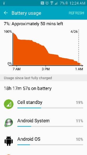

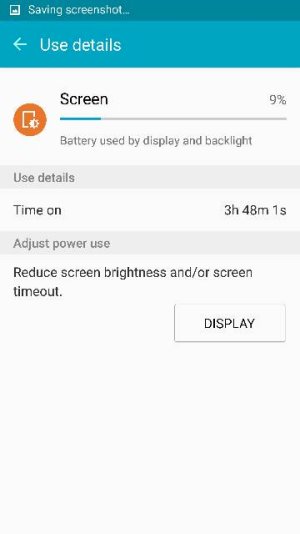

First full day with my edge today. Battery life has been quite solid with minimal usage. At 9+ hours off the charger, I'm sitting at 70%. According to GSam, though, WiFi Active is accounting for over 30% of that. I've had my wifi on and connected while home, and off for several hours while shopping this afternoon/evening. "Cell standby" is at 6% in the stock Galaxy battery center, but the WiFi and phone radio (12%) numbers are higher than I was used to on my S4.
Even with cell standby I get solid battery life

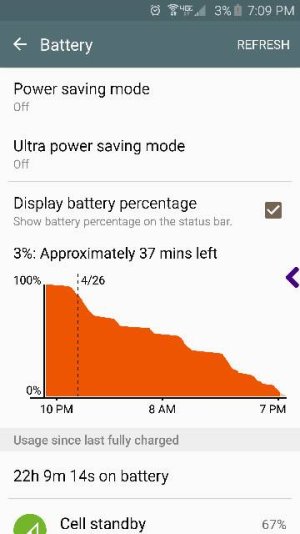

Performance since last full charge. Cell standby at all time high for me... still getting stellar batter life. Can only get better from here folks ;-)
