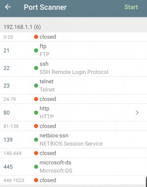

Diddy, I use the netanalyzr app to check for the port, I found some interesting results. When I checked for the main router (192.168.1.1) , it showed some ports open.

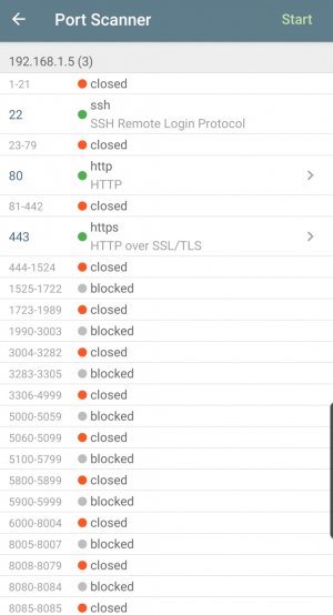

Got a slightly different result for the tp link( 192.168.1.5)dont know why since its acting only as access point.

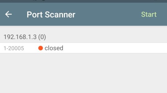

On the note 9 ( 192.168.1.3), the result was shocking. All ports are closed.
I have attached screenshots for all three.
Dont know why ports on note 9 showing closed.
