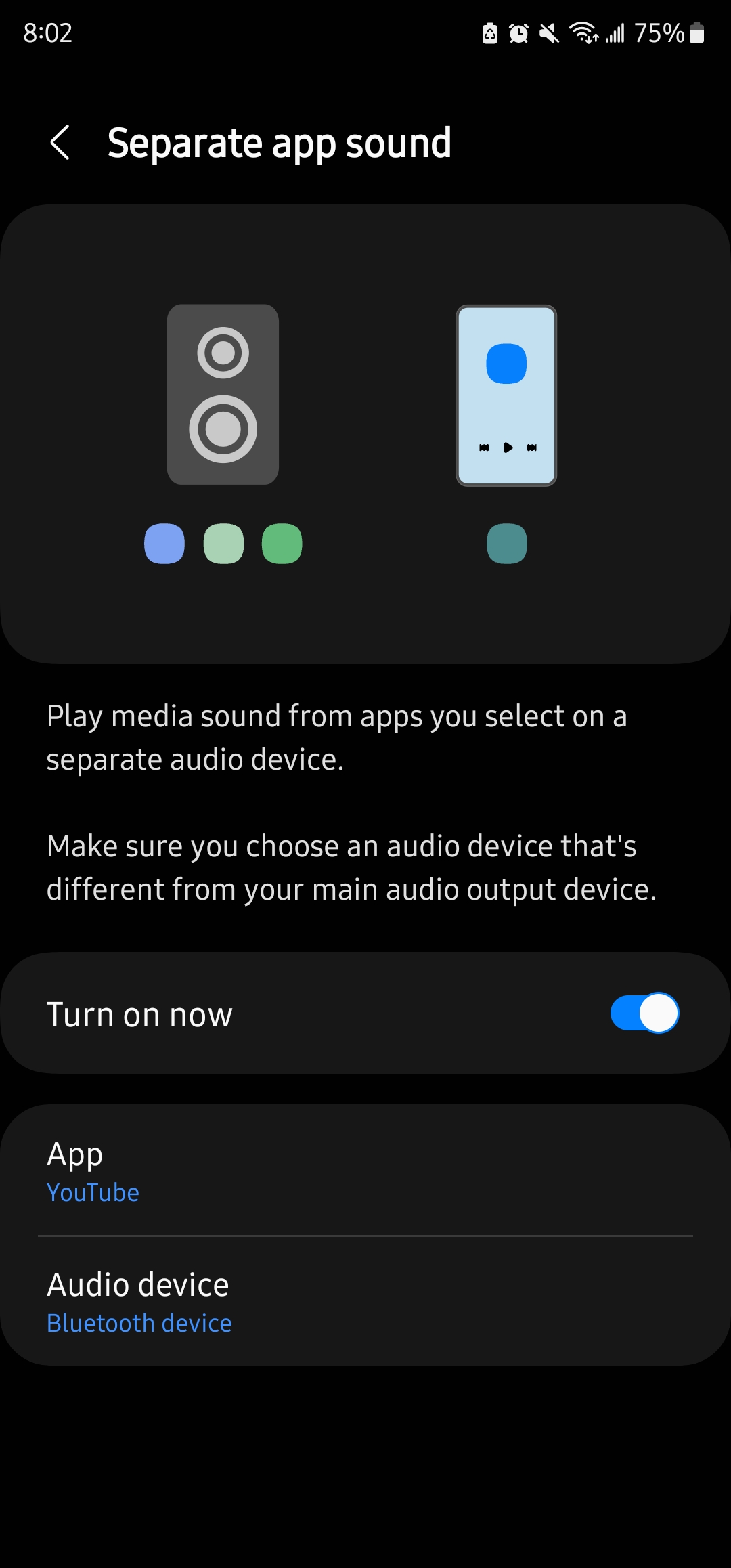

mustang7757
Super Moderator
Moderator
Feb 6, 2017
93,401
8,190
113
Visit site
In settings>sounds and vibration>can select a Bluetooth device such as a speaker
