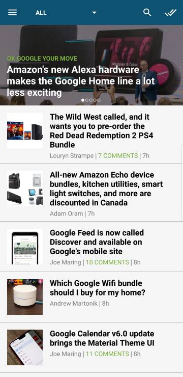

My note 9 has suddenly started hiding the nav bar and the status bar on everything but the home screen. If I click the dot to lock the nav bar it still disappears.
I have tried restarting phone, booting in safe mode and clearing cache but nothing seems to work. Any help would be appreciated as I would rather not reset the phone if it can be avoided//uploads.tapatalk-cdn.com/20180925/79fa61e1130d46d50df4b53f8df63558.jpg

Sometimes is the app that will remove the navigation bar. However mine stayed on for the AC home page, unlike your screenshot.
