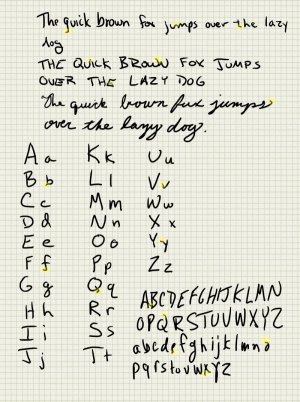

Hello everyone. I just purchased my GN 10.1 on Sunday, and after four days of taking notes for my classes, I'm noticing that the S-Pen might not be as accurate as I thought (or I have a defective unit).

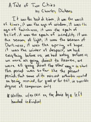

On occasion, when I'm lifting my pen off the screen to finish writing a letter, a small tail will shoot out the end. At first I thought it was my case - I had read that the magnet on the back of the Samsung case can throw off the S-Pen, but even with the case off the device I'm still getting these "tails" on some of my letters.
I've attached a screen shot to show what I'm talking about - see yellow highlights. It doesn't matter if I'm writing quickly or slowly, and it's not limited to just the S-Note app. I'm also having the same problem when taking notes on my textbook in the Kno application. I usually write small, so these tails can get annoying, especially in class when I need to quickly erase or undo the tail and pick up where I left off.
Is this someone wrong with my device or just a normal issue with the S-Pen?
I'd greatly appreciate any feedback.
Thanks!
Rick

I noticed the same thing when i draw in the game draw something. When i trace something or just finish a line i always get a tail like you mentioned when u pick my pen up off the screen. I thought it was just the way i was lifting the pen up or just me. I tried slowing down when picking it up, but can't remember if that helped or not. I always have to go back and erase as you said. Glad you posted this. I'll try and see if i can attache some screenshots when it happens again. I do draw and write fast, so may not always totally lift pen up.

I just tried that...even with it on low sensitivity, it still did the same thing.
I'm going to exchange my tablet tonight. Hopefully I just have a defective unit. I would still appreciate anyone else sharing if they have a similar issue.

The magnet on my case was messing with some sort of sensor that tells the tablet if the pen is plugged in or pulled out. So the pen would either work or not work. Actually I noticed the pen itself is attracted to the magnets in the edge of the case. But I believe that is a separate issue from the tail your getting. Its only when the magnet in the case is located near the slot where the pen is plugged in that I ever had a problem, and I can recreate the issue by folding my case a certain way. I like my case so I just dont fold it that way when I use the pen.
I get the tail as well sometimes and assumed it was my writing style. It doesnt happen all the time, and hasn't been a problem but more of an annoyance. It also happens when my tablet is removed from the case. Love my tablet, so I guess I just over look the issue. Will try some of the things mentioned and would be curious how another styles works.
