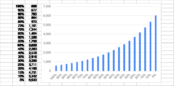

That's the simple part, but the trickier part is getting the real numbers to substitute for the expected number of cycles that correspond to each level of normal discharge. Which the numbers that @chanchan05 quoted, c when d = 100% and c when d = 50% are a calculation from his post. The closest I was able to come to matching those numbers was c multiplying by 1.275 for every 10% (gross) increase in d. So c for d = 90% would be 765, for 80% it'd be 975, etc. The formula for that, if anyone wants it, is c = 600*1.275^((1-d)/.1).
But if you know you only charge once every other day, and it's 80%, then we would simply have to figure out the c when d = 80% and modify the time calculation to account for less frequent charges.
Here's what I get for a scale using c + 600*1.275^((1-d)/.1):
