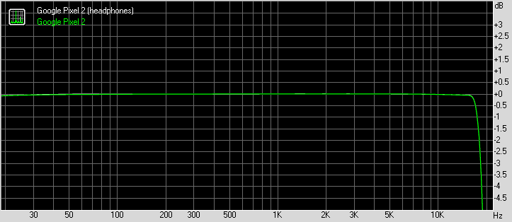

I found a frequency response graph for the Pixel 2 Dongle (from GSM Arena):
Compared to a dedicated player like the DX80:
It kinda reflects the roll-off at the high-end I was hearing. But overall, the Pixel 2 seems to be pretty flat, which is a good thing. Basically this means your music will come out pretty close to the intended sound when it was mixed at the studio.
