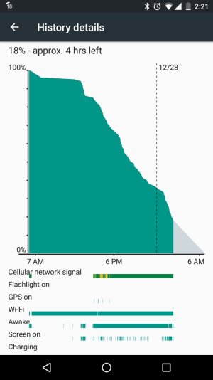

Well, only lost 5% last night and the battery graph was relatively flat. Unfortunately, I took a screenshot of the wrong screen then plugged it in and erased the history again. If I recall correctly, WiFi was solid green most of the night and there was barely any awake. So maybe the other night was just a one time occurrence. I'm going to try again tonight.

Here is what happened to me today after I turned off Bluetooth last night. No more solid awake.
So, the first night this all started, my cellular signal was the problem and WiFi didn't seem to be working overnight. The second night, WiFi was fine and cellular was not being used so Doze worked great. Just last night, it's back to using cellular all night. I have to keep experimenting or something. Any comment on this battery reading?

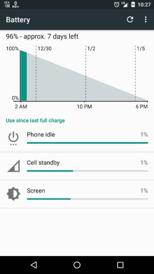

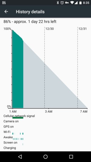

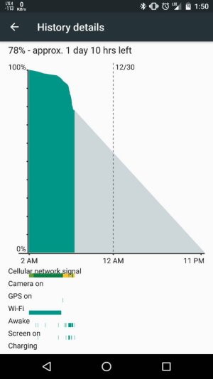

This was mine last night. I charged, used it a little before bed, and then took this in the morning. Wifi stayed on the whole time (till I left for work and shut it off) I just took the second screenshot now to show the awake bar.

My phone doesn't have a solid awake bar and has some dashes when the screen is off but nothing like yours. I just shut off my Google Now cards and I'll see how that does. I really wish I could figure what app is waking my phone
