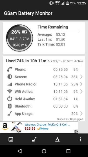

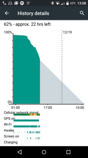

For those that had poor battery performance, did a factory reset fix it? My battery isn't lasting as long as my old Maxx. I'm trying to hold off until the 6.0 update but I'm getting anxious. The attached pictures are from today.

With your bluetooth on I don't think your battery was horrible, you got almost 3hrs sot. I am not sure any high performing phone even with a monster battery us going to last and last with moderate to heavy usage. I am right there with you I am not really happy with the battery. I have not done a factory reset because I am not sure its going to help. I did disable al the bloat wear and turn off all the wifi scaning etc. My battery is doing a lot better now. I went to bed with 50% left last night.But my phone is still held awake for over 3hrs and I can't figure out why. I have been lucky to get 2hrs of sot last night if I would have had time I think I would have made it to 3hrs maybe. I will probably do a facotry reset when M comes out which is looking sooner then later hopefully. The hard part is there is no consistancy on why some people seem to get close to 6hrs sot. Maybe its cell signal who knows. It is very frustrating.

8.2% an hour with less than 3 hours screen time in 8 hours with 77% used by the phone radio? Something is up...
Do you travel through or work in areas with really bad signal?
No that's the thing, my commute is 2 miles and I constantly have solid 4g connection at work and at home. Maybe I'll switch from global to LTE/CDMA to see if that does anything. I never had any connection issues with my other moto phones.

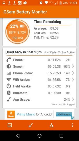

I just picked up this phone. Will post some shots.
6 hours of SOT including watching a 90 minute movie on YouTube and started monitoring at 90% so actually 7 hours of SOT
5 hours of browsing web.
Seems good

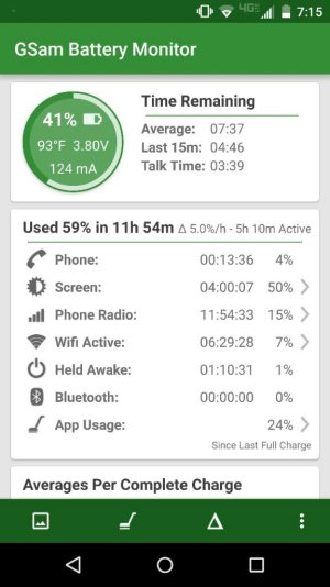

Much better results today with similar usage as yesterday. The only change I did was change the network type from global to LTE/CDMA and I did do a soft reset before I charged it.

This was my best day
