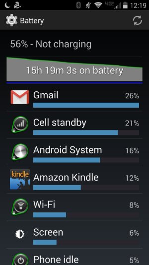

So I was averaging 2 days after getting a replacement phone due to an issue with the speaker in my first one. I thought I had a better battery as the original phone averaged 30-36 hours which seems typical for average users like me. Then I added a single POP3 account to GMAIL that gets maybe 10 - 20 emails a day, with polling set to 30 minutes.
And there you have it. A crappy mail program that can't even do a Select All or Mark All Read sucks 25% of my battery life which is now down to the same 30-36 hours as before based on a single POP3 account. I've seen multiple complaints similar to mine related to Gmail, so I know this isn't an anomaly (also, Gmail used similar battery on 2 separate phones.) Does anybody know of a simple solution to this Gmail issue?

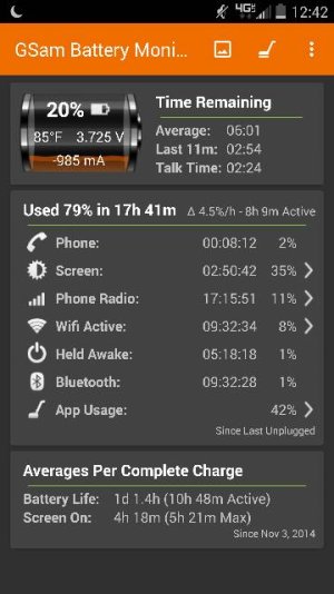

Okay, here are my results from today. A few things-
1. Usage today consisted of texting and web browsing, as well as 15 minutes of playing a game.

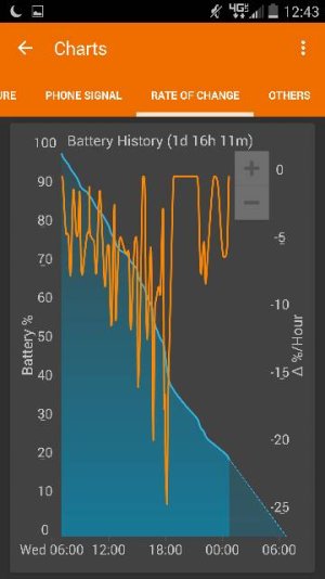

2. It's odd that the during the period of time my phone was in deep sleep and had ~1% Discharge per hour, my battery percentage dropped at least 10%. See pic 2.

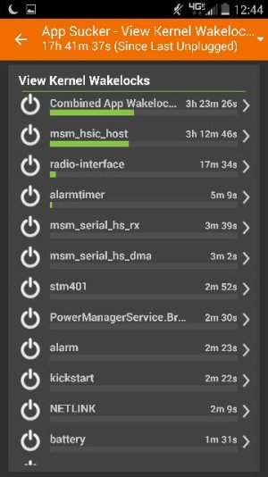

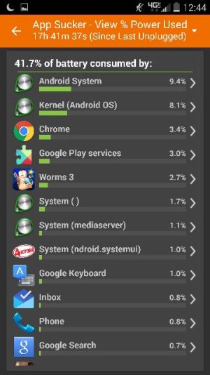

3. Android and Kernel are both sucking up a lot of power. Too much if you're asking me.
4. My phone wakelocks seem high. I've disabled syncing for most things besides google inbox and contacts. Notifications are turned off on any apps that aren't related to communication or work.
I'm just not sure if this is typical or not. I am definitely not a super heavy user, yet my turbo barely gets me through a day. Should I try wiping my phone and starting over? What are people's results that have gotten a new phone from Motorola?
