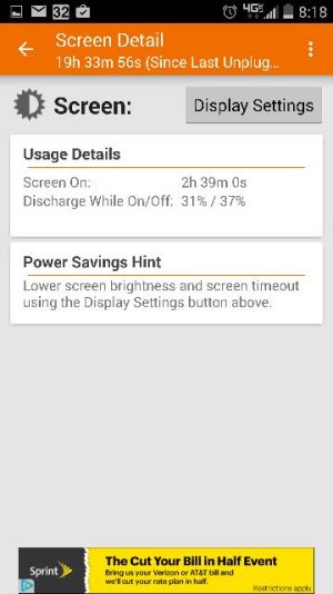

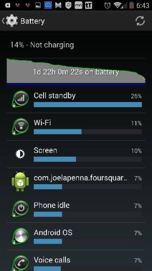

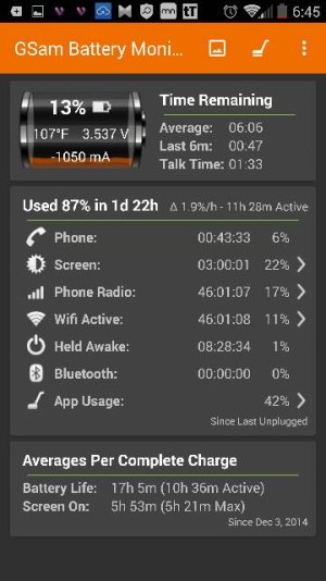

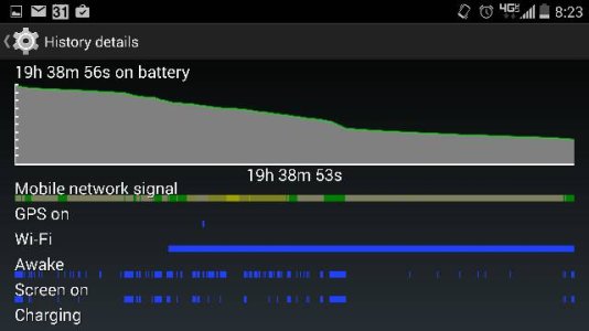

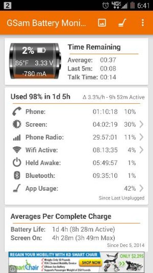

Well I came home at 46% tonight instead of 30%. Still not droid Maxx quality but slightly better day. Here is a wake lock screen. It consistently seems to be that combined one of the top.

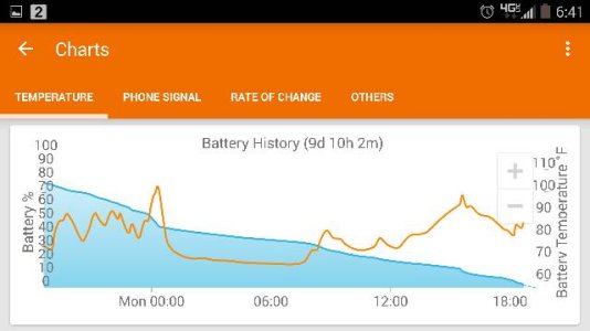

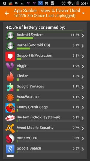

What am I doing wrong and why has my battery decreased. He here is the latest. I have volte off and updated Friday night. Cleared my cache as well

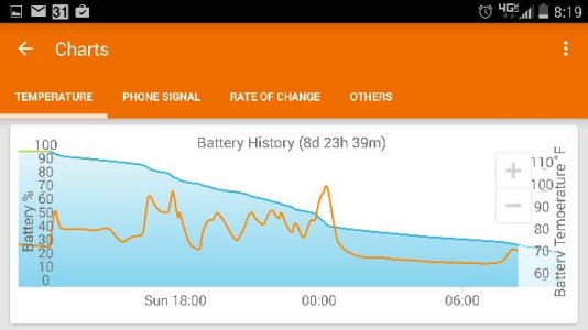

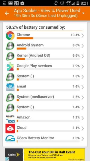

How is this bad? 50% in 19 hours with over 2.5 SOT. I would say that's excellent.

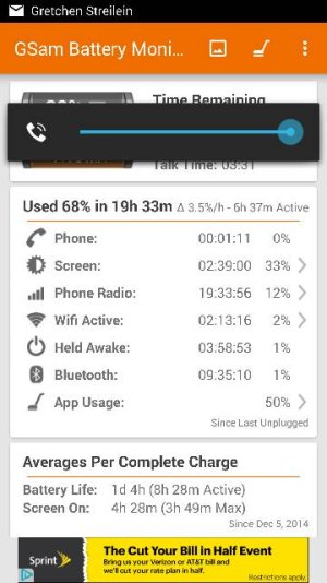

Here is my latest

Almost 48 hours.

It guess a little better but no where near others stats. This was all after the update. Are all batteries different and is there anything I might have running that's draining battery?
