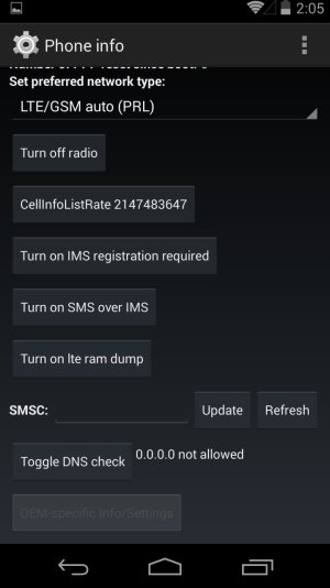

an interesting thing about our nexus 5s, are these settings -
which from this screenshot, i don't if they are toggle ON or OFF, but it shows capabilities..
