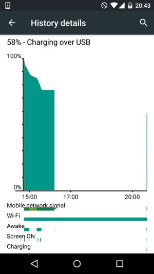

My nexus 5 (just over two years old) has taken to switching off at apparently random moments. If I turn it on again, it usually shows about 3% battery life; if I then turn it off and on again, this sometimes goes up to around 25%. If I plug it in, it starts charging from a higher figure. Here's a recent example of the battery charging screen:

Thanks -- at least if it's only the battery, I can try replacing it. Spudger at the ready. :)
