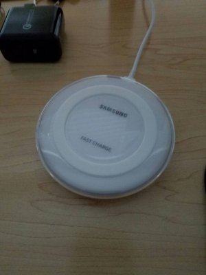

Hm maybe it's the stand that has an issue. I use this one and it goes pretty fast for wireless charging.
I have the official Samsung one from amazon as well. Mine definitely charges much faster than yours. It is pretty close to the speed of the wired fast charger.

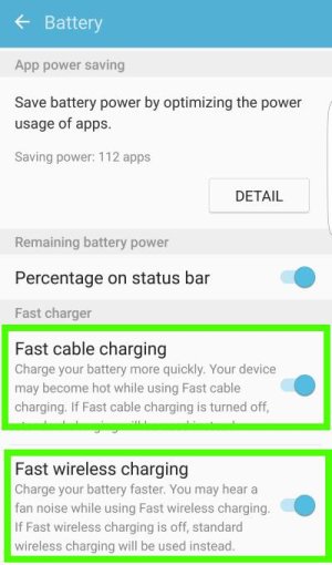

Dude did you enable fast wireless charging ?
It's an option you can turn off or on - go to settings - battery and you'll see at the bottom an option to turn fast cable charging and fast wireless charging on or off...
Please check that out .
