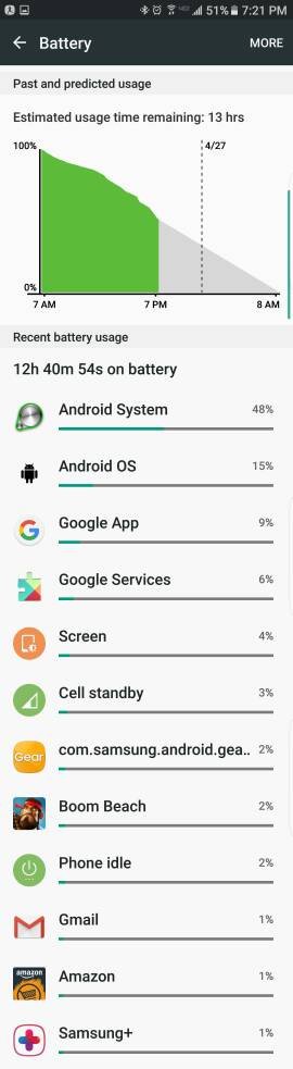

Lance, whats your battery life like on the phone if you are connecting the s2 via blue tooth. I am getting about 14 hours or less, but according to gsam battery bluetooth is less than 2 % usage. For the past week, Ive not connected the s2 via blue tooth and Im over 24 hours of battery time.
Battery life is still looking good after adding the s2 to the lineup ;)
Sent from my Adamantium™ S7 edge
Thanks, I guess its just me, but with the S2 connected I really am at 15hrs battery on the phone. Close to 40 hours without the S2. I do have Shealth, maybe I could try turning that off.

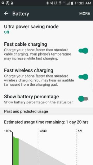

Dude did you enable fast wireless charging ?
It's an option you can turn off or on - go to settings - battery and you'll see at the bottom an option to turn fast cable charging and fast wireless charging on or off...
Please check that out .

Go to settings and make sure you have fast wireless charging set on.
Yea, why from time to time does this get turned off?? I found numerous times it was switched off and I never went into those settings.. Very strange..
LOL, you're funny! As stated many times in this thread, including the first post, it is turned on and when charging, states it is fast charging with the amount of time left under it (on the lock screen).
I haven't had that happen. Do you have any apps that might be turning it off on you, like an app that changes settings per your location? (The built-in ones that do that I haven't seen the option to change the charge type, but I guess there could be a third-party app that does.)
