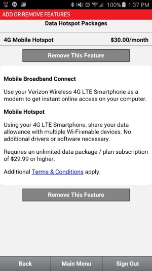

They definitely do. Go to your account and you can add unlimited mobile hotspot for $29 a month. You can then tether as much as you want without any hacks / root / anything. It makes it an official hotspot.

First, Verizon is the only one to offer unlimited unthrottled un optimized 4GLTE data on their legacy plan. All the other carriers subject you to optimization when in high load situations after meeting certain data usage thresholds.
Secondly, Verizon is the only one to offer unlimited unthrottled un optimized 4GLTE hotspot officially on any Verizon 4glte device. Other carriers might allow it on certain devices or certain hacks, but there is no official unlimited unthrottled 4GLTE hotspot. Keep in mind that this is a legacy plan...
And you can put it on and take it off at any time. I tried to take it off and put it on earlier this month and it still worked.
