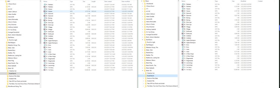

Ok so looking at the files on my PC vs my Samsung I'm noticing that the 'date created' field has no information on my Android.
Also the date modified field is incorrect as Android has changed it to the date that I copied the files to the phone. It should not do that. The date modified should be the last time and 'changes' were made to that file.
The SD card on my LG matches both of these fields exactly as it should.
I hope there is a way to fix this Android blunder....
You can see the issue in the attached picture. PC on the left and Android on the right.

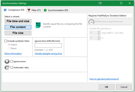

So I can switch to compare by 'file content' instead of 'file time and size' which I assume will work but I don't have time right this second... as unfortunately this particular comparison will take about 75 minutes... compared to about 30 seconds using file size and date.
This is definitely a phone issue as I use this software with my NAS, SD cards, external hard drives, etc. and it's works perfect. So if possible I need to figure out how to make the phone save the files properly when copied over.

Problem solved. Learned how to adjust setting in FFS for handle this situation.
