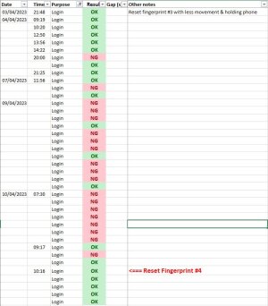

Well here are some of my results
I have 4 copies of the same finger saved.
After resetting copy #3, it worked reasonably well for a while.
Then reverted to the usual high failure rate.
So I re-entered fingerprint #4 and it starts working for a while.
Yes, my hands are clean and I cleaned the Pixel screen.
For a benchmark, my LG G7 fingerprint sensor worked every time I went to it during this trial.
Note: Most of the time, if the phone catches sight of my face, the face unlock unlocks the phone.
The face unlock works very well.
To test the fingerprint login, I need to keep my face out of sight of the camera !
I need the fingerprint login for bank apps.

Well I'm continuing to trial the fingerprint sensor.
1 Re-saving the fingerprints with a smaller change in position when they say to put the left edge of the finger on, right edge etc has increased my pass rate from about 33% to 53%. Of course, this is still poor.
2 Numerous other places have reports of people with fingerprint sensors. One of them reported success saving the fingerprint in a dark room. So I tried that. It was better for a day or two, then started deteriorating.
What I actually find is every time I save a fingerprint, results are better for 2~3 days, then it gets worse.
3 The failure rate is particularly high when I wake up in the morning. Wetting my finger helps, as it sometimes does at other times of the day.
